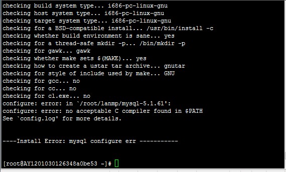

全新安裝的時(shí)候,install Error :mysql configure errr

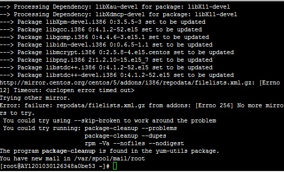

  1. yum install -y gcc gcc-c++ make autoconf libtool-ltdl-devel gd-devel freetype-devel libxml2-devel libjpeg-devel libpng-devel openssl-devel curl-devel patch libmcrypt-devel libmhash-devel ncurses-devel sudo bzip2
復(fù)制代碼
然后出現(xiàn)
  1. ---> Package libstdc++-devel.i386 0:4.1.2-52.el5 set to be updated
  2. http://mirror.centos.org/centos/5/addons/i386/repodata/filelists.xml.gz: [Errno 12] Timeout: <urlopen error timed out>
  3. Trying other mirror.
  4. Error: failure: repodata/filelists.xml.gz from addons: [Errno 256] No more mirrors to try.
  5. You could try using --skip-broken to work around the problem
  6. You could try running: package-cleanup --problems
  7. package-cleanup --dupes
  8. rpm -Va --nofiles --nodigest
  9. The program package-cleanup is found in the yum-utils package.
  10. You have new mail in /var/spool/mail/root
復(fù)制代碼
重新安裝還是出現(xiàn)最面的那個(gè)錯(cuò)誤,install Error :mysql configure errr,也把

圖片附件: 1.jpg (2012-3-11 14:50, 66.07 KB) / 下載次數(shù) 9460

圖片附件: 2.JPG (2012-3-11 14:54, 94.26 KB) / 下載次數(shù) 9504

  1. ---> Package libXpm-devel.i386 0:3.5.5-3 set to be updated

  37. configure: error: in `/root/lanmp/mysql-5.1.61':
  38. configure: error: no acceptable C compiler found in $PATH
  39. See `config.log' for more details.
  40. ----Install Error: mysql configure err -----------

  129. http://mirror.centos.org/centos/5/addons/i386/repodata/filelists.xml.gz: [Errno 12] Timeout: <urlopen error timed out>
  130. Trying other mirror.
  131. Error: failure: repodata/filelists.xml.gz from addons: [Errno 256] No more mirrors to try.
  132. You could try using --skip-broken to work around the problem
  133. You could try running: package-cleanup --problems
  134.                         package-cleanup --dupes
  135.                         rpm -Va --nofiles --nodigest
  136. The program package-cleanup is found in the yum-utils package.

  141. checking host system type... i686-pc-linux-gnu
  142. checking target system type... i686-pc-linux-gnu
  143. checking for a BSD-compatible install... /usr/bin/install -c
  144. checking whether build environment is sane... yes
  145. checking for a thread-safe mkdir -p... /bin/mkdir -p
  146. checking for gawk... gawk
  147. checking whether make sets $(MAKE)... yes
  148. checking how to create a ustar tar archive... gnutar
  149. checking for style of include used by make... GNU
  150. checking for gcc... no
  151. checking for cc... no
  152. checking for cl.exe... no
  153. configure: error: in `/root/lanmp/mysql-5.1.61':
  154. configure: error: no acceptable C compiler found in $PATH
  155. See `config.log' for more details.
  156. ----Install Error: mysql configure err -----------
復(fù)制代碼
作者: admin    時(shí)間: 2012-3-11 18:18
DNS錯(cuò)誤,域名解釋不了
所以
這個(gè)也沒(méi)更新成功
作者: 阿飛劉    時(shí)間: 2012-3-11 19:39
那怎么解決
作者: admin    時(shí)間: 2012-3-11 22:35
換一個(gè)DNS
作者: 阿飛劉    時(shí)間: 2012-3-12 08:04
換虛擬主機(jī)的dns?
作者: 小蛋    時(shí)間: 2012-3-13 12:04
我有一臺(tái)5.4的也是這個(gè)問(wèn)題。不理解咋 回事
作者: admin    時(shí)間: 2012-3-13 12:48
DNS不行,所以域名解析不了,所以yum更新不成功,所以沒(méi)有相關(guān)的依懶包和庫(kù),所以安裝不成功
可以換一個(gè)DNS試試,可以看/etc/resolv.conf這個(gè)文件
