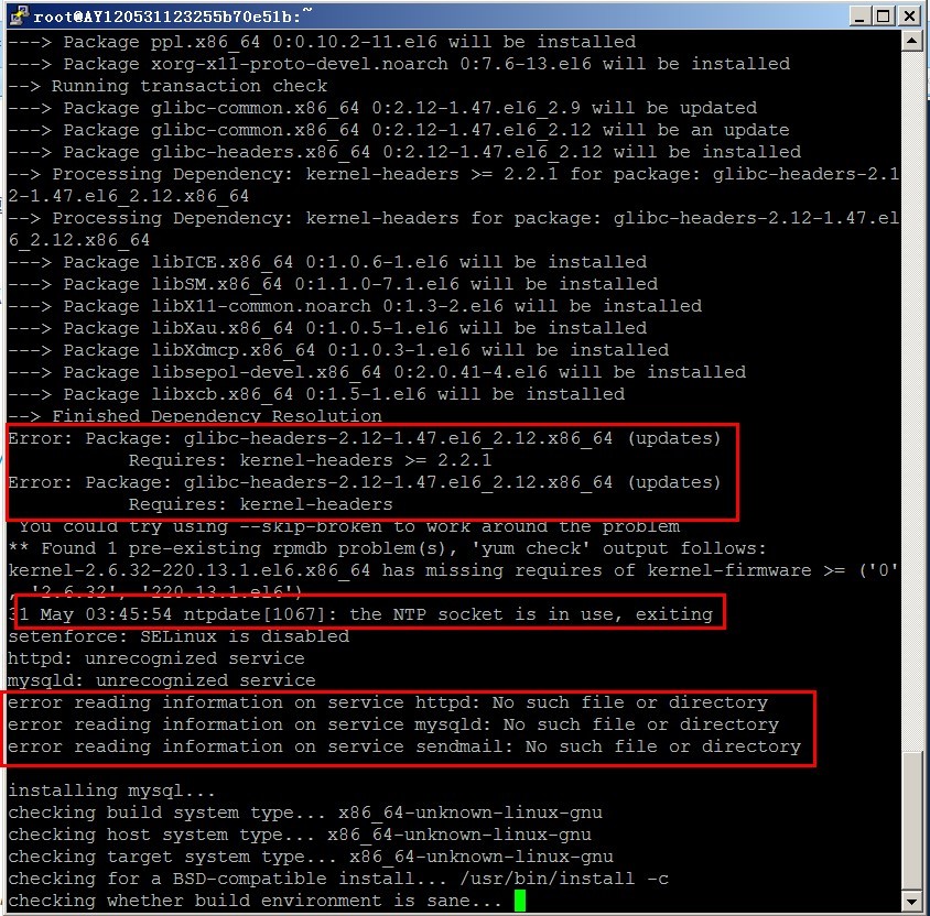

在阿里云的VPS上安裝不了,阿里云的VPS,數(shù)據(jù)盤(pán)是單獨(dú)一個(gè)虛擬硬盤(pán),我mount /dev/xvdb /www 然后寫(xiě)入/etc/fstab,之后重啟,然后下載安裝包,解壓安裝,到了mysql就出錯(cuò)停住了

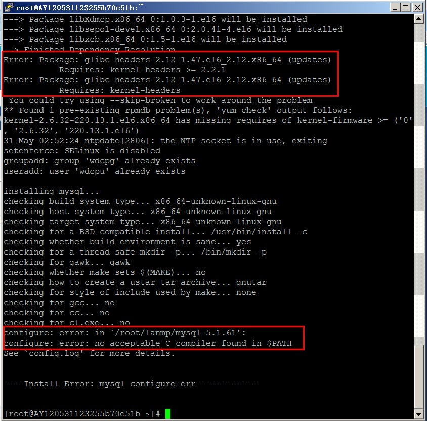

重裝系統(tǒng)之后,下載2.2版本的安裝包,錯(cuò)誤依舊:

作者: xy83918    時(shí)間: 2012-6-1 00:52
  1. useradd: user 'wdcpu' already exists
  2. installing mysql...
  3. checking build system type... x86_64-unknown-linux-gnu
  4. checking host system type... x86_64-unknown-linux-gnu
  5. checking target system type... x86_64-unknown-linux-gnu
  6. checking for a BSD-compatible install... /usr/bin/install -c
  7. checking whether build environment is sane... yes
  8. checking for a thread-safe mkdir -p... /bin/mkdir -p
  9. checking for gawk... gawk
  10. checking whether make sets $(MAKE)... no
  11. checking how to create a ustar tar archive... gnutar
  12. checking for style of include used by make... none
  13. checking for gcc... no
  14. checking for cc... no
  15. checking for cl.exe... no
  16. configure: error: in `/root/lanmp/mysql-5.1.61':
  17. configure: error: no acceptable C compiler found in $PATH
  18. See `config.log' for more details.
  19. ----Install Error: mysql configure err -----------
復(fù)制代碼
作者: xy83918    時(shí)間: 2012-6-1 01:17
我在網(wǎng)上查是因?yàn)闆](méi)裝gcc但安裝gcc時(shí)出現(xiàn)如下錯(cuò)誤
  1. Error: Package: glibc-headers-2.12-1.47.el6_2.12.x86_64 (updates)
  2.            Requires: kernel-headers >= 2.2.1
  3. Error: Package: glibc-headers-2.12-1.47.el6_2.12.x86_64 (updates)
  4.            Requires: kernel-headers
  5. You could try using --skip-broken to work around the problem
  6. ** Found 1 pre-existing rpmdb problem(s), 'yum check' output follows:
  7. kernel-2.6.32-220.13.1.el6.x86_64 has missing requires of kernel-firmware >= ('0
  8. ', '2.6.32', '220.13.1.el6')
復(fù)制代碼
