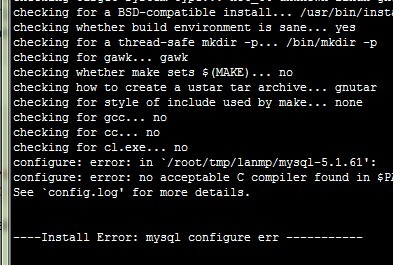

在安裝一鍵包里,有些會(huì)提示如下圖這樣,就不能安裝了
類似這樣的,是因?yàn)闆]有GCC編譯環(huán)境等,只要
運(yùn)行下
  1. yum install -y gcc gcc-c++ make autoconf libtool-ltdl-devel gd-devel freetype-devel libxml2-devel libjpeg-devel libpng-devel openssl-devel curl-devel patch libmcrypt-devel libmhash-devel ncurses-devel sudo bzip2
復(fù)制代碼
然后再次安裝就可以

運(yùn)行完這個(gè)命令,是不是重新安裝 運(yùn)行sh in.sh 從新安裝嗎。
作者: admin    時(shí)間: 2012-9-29 16:56
是的

為什么運(yùn)行了yum install -y gcc gcc-c++ make autoconf libtool-ltdl-devel gd-devel freetype-devel libxml2-devel libjpeg-devel libpng-devel openssl-devel curl-devel patch libmcrypt-devel libmhash-devel ncurses-devel sudo bzip2
還是一樣的出現(xiàn)了這個(gè)問題啊
作者: 541960899    時(shí)間: 2013-8-2 12:07
回復(fù) 1# admin 運(yùn)行了yum install -y gcc gcc-c++ make autoconf libtool-ltdl-devel gd-devel freetype-devel libxml2-devel libjpeg-devel libpng-devel openssl-devel curl-devel patch libmcrypt-devel libmhash-devel ncurses-devel sudo bzip2然后重新裝,還是一樣的出現(xiàn)這個(gè)情況。

這個(gè)明顯不行嗎,里面什么都沒有。
Setting up Install Process
No package gcc-c++ available.
No package autoconf available.
No package libtool-ltdl-devel available.
No package gd-devel available.
No package freetype-devel available.
No package libxml2-devel available.
No package libjpeg-devel available.
No package libpng-devel available.
No package openssl-devel available.
No package curl-devel available.
No package patch available.
Package libmcrypt-devel-2.5.7-1.2.el5.rf.x86_64 already installed and latest version
Package mhash-devel-0.9.9-1.el5.rf.x86_64 already installed and latest version
No package ncurses-devel available.
Nothing to do
什么都做不了。
