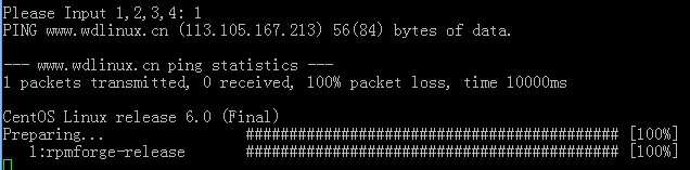

本人有塊微星H61,裝個liunx測試下
CentOS6.0安裝時提示
dns err
用winscp連接服務(wù)器
打開/etc/sysconfig/network-scripts/ifcfg-eth0
編輯網(wǎng)卡配置ifcfg-eth0
DEVICE="eth0"
NM_CONTROLLED="yes"
ONBOOT=yes
HWADDR=00:0B:2F:65:A8:67
TYPE=Ethernet
BOOTPROTO=none
IPADDR=192.168.1.110
PREFIX=255.255.255.0  /===原來的是24===/
GATEWAY=192.168.1.1
DNS1=112.100.100.100  /===安裝系統(tǒng)時填錯了!122.100.100.100===DNS填錯了@/
DEFROUTE=yes
IPV4_FAILURE_FATAL=yes
IPV6INIT=no
NAME="System eth0"
UUID=5fb06bd0-0bb0-7ffb-45f1-d6edd65f3e03
正常后的截圖
圖片附件: E[)6W{UK(M95J1OVH}%%AOD.jpg (2011-12-1 12:15, 7.03 KB) / 下載次數(shù) 6455
http://m.gps-cemuyi.cn/bbs/attachment.php?aid=58&k=95602509856b3636f7876c4e433059f4&t=1746532088&sid=ycmtdD
圖片附件: QOJHR[_UF}}O{TI1O0J4ILL.jpg (2011-12-1 12:20, 36.44 KB) / 下載次數(shù) 6415
http://m.gps-cemuyi.cn/bbs/attachment.php?aid=59&k=56ba94bac9a0b828e05acfe2e8922202&t=1746532088&sid=ycmtdD
