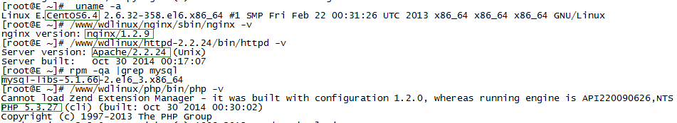

服務器系統(tǒng)和各軟件版本如下所示:
  1. [root@E ~]# uname -a
  2. Linux E.CentOS6.4 2.6.32-358.el6.x86_64 #1 SMP Fri Feb 22 00:31:26 UTC 2013 x86_64 x86_64 x86_64 GNU/Linux
  3. [root@E ~]# /www/wdlinux/nginx/sbin/nginx -v
  4. nginx version: nginx/1.2.9
  5. [root@E ~]# /www/wdlinux/httpd-2.2.24/bin/httpd -v
  6. Server version: Apache/2.2.24 (Unix)
  7. Server built: Oct 30 2014 00:17:07
  8. [root@E ~]# rpm -qa |grep mysql
  9. mysql-libs-5.1.66-2.el6_3.x86_64
  10. [root@E ~]# /www/wdlinux/php/bin/php -v
  11. Cannot load Zend Extension Manager - it was built with configuration 1.2.0, whereas running engine is API220090626,NTS
  12. PHP 5.3.27 (cli) (built: Oct 30 2014 00:30:02)
  13. Copyright (c) 1997-2013 The PHP Group
  14. Zend Engine v2.3.0, Copyright (c) 1998-2013 Zend Technologies

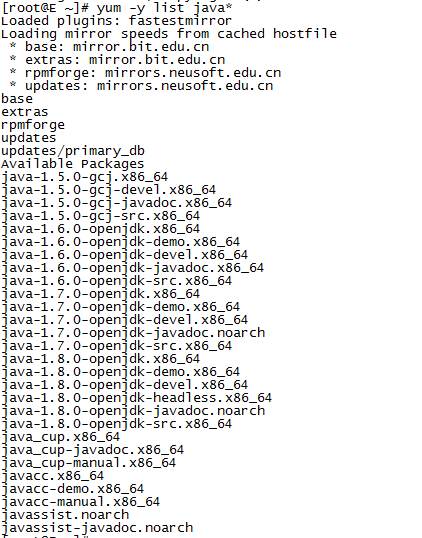

開始安裝jdk:
列出yum庫可用的jdk安裝包
  1. [root@E ~]# yum -y list java*
  2. Loaded plugins: fastestmirror
  3. Loading mirror speeds from cached hostfile
  4. * base: mirror.bit.edu.cn
  5. * extras: mirror.bit.edu.cn
  6. * rpmforge: mirrors.neusoft.edu.cn
  7. * updates: mirrors.neusoft.edu.cn
  8. base | 3.7 kB 00:00
  9. extras | 3.3 kB 00:00
  10. rpmforge | 1.9 kB 00:00
  11. updates | 3.4 kB 00:00
  12. updates/primary_db | 171 kB 00:00
  13. Available Packages
  14. java-1.5.0-gcj.x86_64 1.5.0.0-29.1.el6 base
  15. java-1.5.0-gcj-devel.x86_64 1.5.0.0-29.1.el6 base
  16. java-1.5.0-gcj-javadoc.x86_64 1.5.0.0-29.1.el6 base
  17. java-1.5.0-gcj-src.x86_64 1.5.0.0-29.1.el6 base
  18. java-1.6.0-openjdk.x86_64 1:1.6.0.33-1.13.5.0.el6_6 updates
  19. java-1.6.0-openjdk-demo.x86_64 1:1.6.0.33-1.13.5.0.el6_6 updates
  20. java-1.6.0-openjdk-devel.x86_64 1:1.6.0.33-1.13.5.0.el6_6 updates
  21. java-1.6.0-openjdk-javadoc.x86_64 1:1.6.0.33-1.13.5.0.el6_6 updates
  22. java-1.6.0-openjdk-src.x86_64 1:1.6.0.33-1.13.5.0.el6_6 updates
  23. java-1.7.0-openjdk.x86_64 1:1.7.0.71-2.5.3.1.el6 updates
  24. java-1.7.0-openjdk-demo.x86_64 1:1.7.0.71-2.5.3.1.el6 updates
  25. java-1.7.0-openjdk-devel.x86_64 1:1.7.0.71-2.5.3.1.el6 updates
  26. java-1.7.0-openjdk-javadoc.noarch 1:1.7.0.71-2.5.3.1.el6 updates
  27. java-1.7.0-openjdk-src.x86_64 1:1.7.0.71-2.5.3.1.el6 updates
  28. java-1.8.0-openjdk.x86_64 1.8.0.25-1.b17.el6 updates
  29. java-1.8.0-openjdk-demo.x86_64 1.8.0.25-1.b17.el6 updates
  30. java-1.8.0-openjdk-devel.x86_64 1.8.0.25-1.b17.el6 updates
  31. java-1.8.0-openjdk-headless.x86_64 1.8.0.25-1.b17.el6 updates
  32. java-1.8.0-openjdk-javadoc.noarch 1.8.0.25-1.b17.el6 updates
  33. java-1.8.0-openjdk-src.x86_64 1.8.0.25-1.b17.el6 updates
  34. java_cup.x86_64 1:0.10k-5.el6 base
  35. java_cup-javadoc.x86_64 1:0.10k-5.el6 base
  36. java_cup-manual.x86_64 1:0.10k-5.el6 base
  37. javacc.x86_64 4.1-0.5.el6 base
  38. javacc-demo.x86_64 4.1-0.5.el6 base
  39. javacc-manual.x86_64 4.1-0.5.el6 base
  40. javassist.noarch 3.9.0-6.el6 base
  41. javassist-javadoc.noarch 3.9.0-6.el6 base
復制代碼

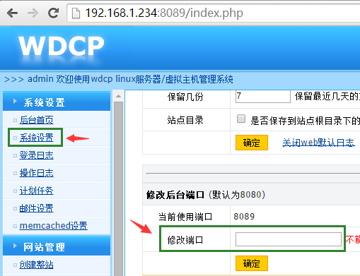

因為wdcp后臺默認安裝的端口是8080,tomcat默認端口也是8080為了避免沖突請?zhí)崆鞍褀dcp后臺端口改為其它端口(如:8089...)
可以到wdcp后臺系統(tǒng)設置中手動修改,如下圖:

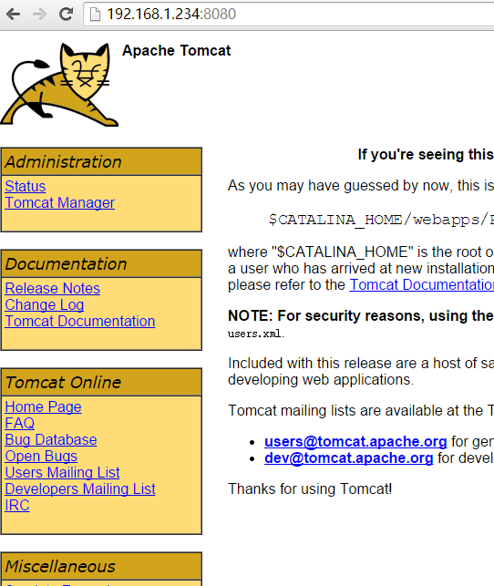

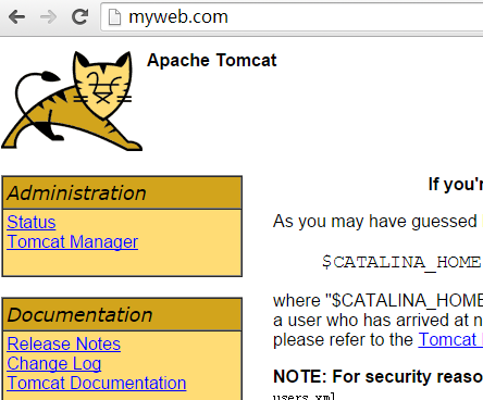

啟動成功,訪問測試:http://ip:8080
如下圖所示即為安裝成功:

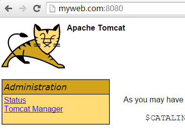

配置nginx和tomcat,使其不加端口號,直接通過域名也能訪問

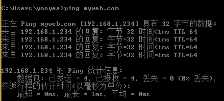

首先增加解析,使域名指向到主機IP,本地可以直接改host實現(xiàn)
解析正常
不加8080端口訪問
添加8080端口訪問

不加端口號訪問測試:
至此nginx已經成功將來自myweb.com域名的請求代理到8080端口

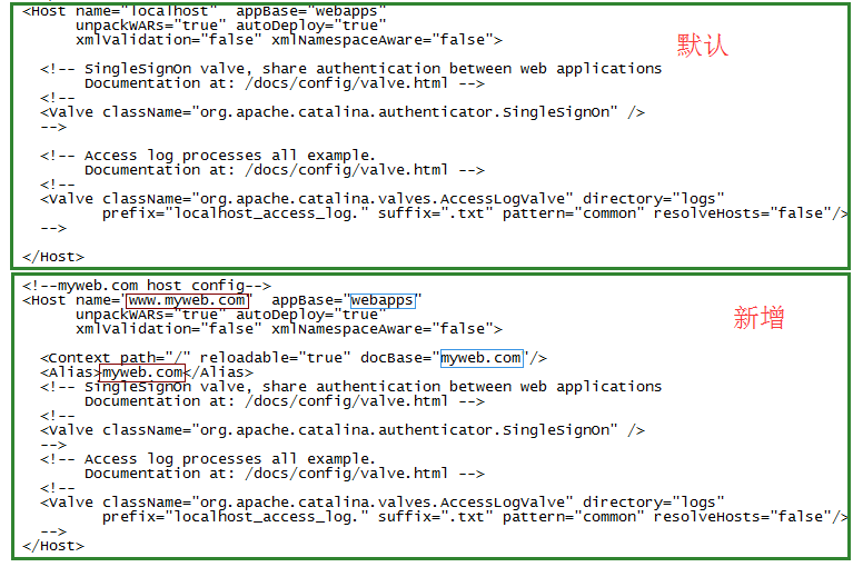

修改tomcat虛擬主機配置
  1. [root@E myweb.com]# vi /etc/tomcat6/server.xml
  2. 在最下面<Host></Host>標簽后面添加如下內容
  3. <!--myweb.com host config-->
  4. <Host name="www.myweb.com" appBase="webapps"
  5. unpackWARs="true" autoDeploy="true"
  6. xmlValidation="false" xmlNamespaceAware="false">
  7. <Context path="/" reloadable="true" docBase="myweb.com"/>
  8. <Alias>myweb.com</Alias>
  9. <!-- SingleSignOn valve, share authentication between web applications
  10. Documentation at: /docs/config/valve.html -->
  11. <!--
  12. <Valve className="org.apache.catalina.authenticator.SingleSignOn" />
  13. -->
  14. <!-- Access log processes all example.
  15. Documentation at: /docs/config/valve.html -->
  16. <!--
  17. <Valve className="org.apache.catalina.valves.AccessLogValve" directory="logs"
  18. prefix="localhost_access_log." suffix=".txt" pattern="common" resolveHosts="false"/>
  19. -->
  20. </Host>
復制代碼
如下圖所示
