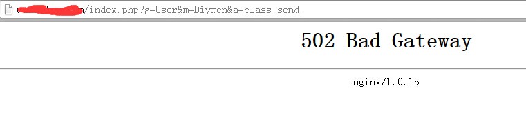

˜Ë(bi¨¡o)î}: [ÇóÖú] wdcpÃæ°å pigcms Ìí¼Ó×Ô¶¨Áx²Ë†Î•r502åeÕ` [´òÓ¡±¾í“]
×÷Õß: fxd2006    •rég: 2014-12-3 11:06     ˜Ë(bi¨¡o)î}: wdcpÃæ°å pigcms Ìí¼Ó×Ô¶¨Áx²Ë†Î•r502åeÕ`
±¾Ìû×îºóÓÉ fxd2006 ÓÚ 2014-12-3 11:28 ¾ŽÝ‹
rt,ÆäËûí“Ãæ¶¼Õý³££¬¾ÍÊÇÌí¼Ó×Ô¶¨Áx²Ë†Î•rÒª³öåeÄØ£¿
Çó´óÉñ‚ƒÖ¸½Ì°¡£¡
ÏàêP(gu¨¡n)log:
/www/wdlinux/nginx/logs/error.log:
conflicting server name ".com" on 0.0.0.0:80, ignored
-bash: conflicting: command not found
/www/wdlinux/nginx_php/logs/php-fpm.log
Jun 29 10:41:13.072354 [WARNING] fpm_children_bury(), line 215: child 10166 (pool default) exited on signal 15 SIGTERM after 7.010952 seconds from start
Jun 29 10:41:13.072378 [NOTICE] fpm_pctl_exit(), line 81: exiting, bye-bye!

ÎÒ„‚é_ʼҲÊÇÄãµÄ†–î}£¬×î½K½â›Q·½°¸£ºÉý¼‰PHP°æ±¾µ½ 5.3 ¼´¿É£¡
