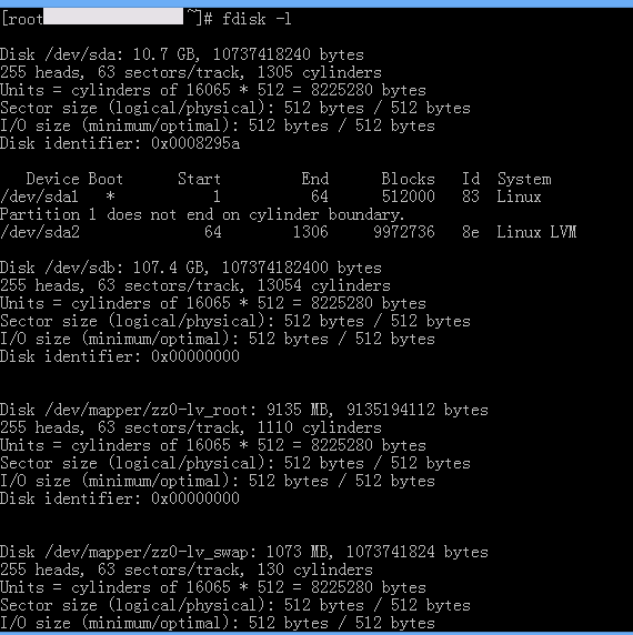

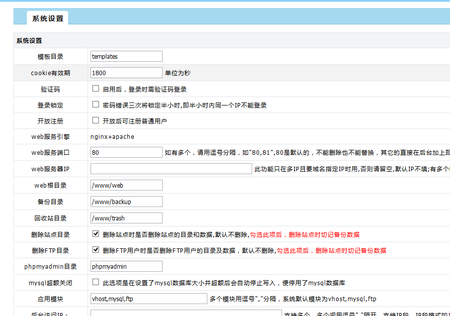

×÷Õß: 5283990    •rég: 2015-11-11 10:53     ˜Ëî}: wdcpĬÕJ¾W(w¨£ng)Õ¾ÔÚϵ½y(t¨¯ng)±P£¬ÈçºÎÞD(zhu¨£n)µ½”µ(sh¨´)“þ(j¨´)±PÈ¥£¿Ð¡°×
°²ÑbµÄϵ½y(t¨¯ng)ÊÇ×ÔŽ§µÄwdcp£¬¾W(w¨£ng)վĬÕJÔÚÁËϵ½y(t¨¯ng)±P¡£
µ«Ïµ½y(t¨¯ng)±P²Å10g²»‰òÓã¬ÙIµÄ•rºòÓЂ€100GµÄϵ½y(t¨¯ng)±P
Ôõ˜Ó²ÅÄܰѾW(w¨£ng)Õ¾”µ(sh¨´)“þ(j¨´)¶¼ÞD(zhu¨£n)µ½ß@‚€100GµÄÓ²±PÉÏÈ¥£¿
ß@˜ÓµÄÃüÁî¿ÉÒÔ†á
mkdir /mnt/sdb
mount /dev/sdb /mnt/sdb
service mysqld stop
service pureftpd stop
service httpd stop
service nginxd stop
mv /www/* /mnt/sdb
umount /dev/sdb
mount /dev/sdb /www
service mysqld start
service pureftpd start
service httpd start
service nginxd start
