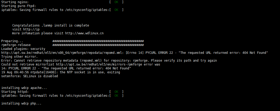

QQ圖片20160819095755.png http://apt.sw.be/redhat/el5/en/x86_64/rpmforge/repodata/repomd.xml: [Errno 14] PYCURL ERROR 22 - "The requested URL returned error: 404 Not Found"
Trying other mirror.
Error: Cannot retrieve repository metadata (repomd.xml) for repository: rpmforge. Please verify its path and try again
Could not retrieve mirrorlist http://apt.sw.be/redhat/el5/en/mirrors-rpmforge error was
14: PYCURL ERROR 22 - "The requested URL returned error: 404 Not Found"
19 Aug 09:40:56 ntpdate[16408]: the NTP socket is in use, exiting
setenforce: SELinux is disabled
系統(tǒng)是,CentOS 6.5 ,64位,按照官方的安裝教程進(jìn)行安裝的

http://apt.sw.be/redhat/el5/en/mirrors-rpmf這個網(wǎng)址失效了,找到y(tǒng)um源安裝文件夾分別編輯以下幾個文件,找到以這個地址開頭的網(wǎng)址 http://apt.sw.be/把它刪除,把最后那個網(wǎng)址放在前面,刪除wdcp重新安裝即可。
