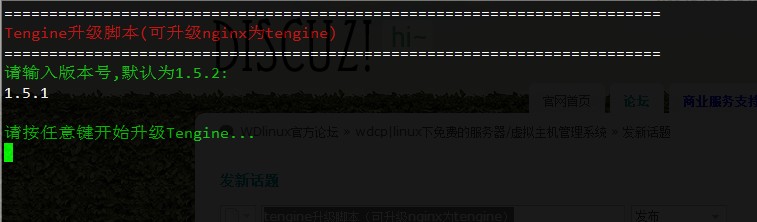

可升級nginx為tengine,如果現(xiàn)在用的是tengine,也可以用此腳本升級tengine版本。此腳本針對使用wdcp的用戶,由nginx升級腳步修改而來,希望對大家有幫助!安裝截圖:

checking for PCRE library ... not found
checking for PCRE library in /usr/local/ ... not found
checking for PCRE library in /usr/include/pcre/ ... not found
checking for PCRE library in /usr/pkg/ ... not found
checking for PCRE library in /opt/local/ ... not found
./configure: error: the HTTP rewrite module requires the PCRE library.
You can either disable the module by using --without-http_rewrite_module
option, or install the PCRE library into the system, or build the PCRE library
statically from the source with nginx by using --with-pcre=<path> option.
配置錯誤,升級失!
[root@AY1402252000021943ccZ ~]#

作者: qushuiyouhan    時間: 2014-3-24 09:56
安裝pcre-devel解決問題
yum -y install pcre-devel
作者: t9913085    時間: 2014-3-24 15:19
安裝pcre-devel解決問題
qushuiyouhan 發(fā)表于 2014-3-24 09:56
   謝謝指導(dǎo)

作者: chatjake    時間: 2014-7-1 16:48
這個腳本有可能會報錯,需要yum -y install pcre-devel   就可以了
