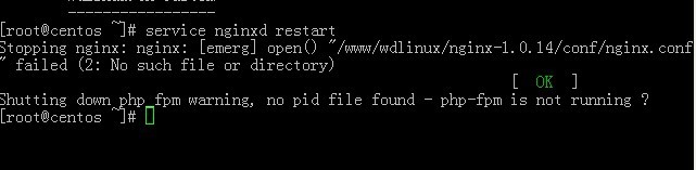

我的也是升級(jí)后無(wú)法打開(kāi)網(wǎng)站
我也升級(jí)了 升級(jí)到1.0.14打不開(kāi)網(wǎng)站了!
管理面板能正常打開(kāi)!

checking for PCRE library in /opt/local/ ... not found
./configure: error: the HTTP rewrite module requires the PCRE library.
You can either disable the module by using --without-http_rewrite_module
option, or install the PCRE library into the system, or build the PCRE library
statically from the source with nginx by using --with-pcre=<path> option.
configure err
老大,nginx的升級(jí) 提示這個(gè)請(qǐng)問(wèn)是升級(jí)有成功嗎
TOP
沒(méi)成功
執(zhí)行
wget http://down.wdlinux.cn/in/pcre_ins.sh
sh pcre_ins.sh
然后再運(yùn)行一次安裝試試
TOP
老大,按你下面的方法試了可以了,謝謝老大
