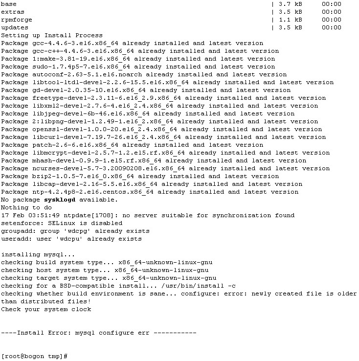

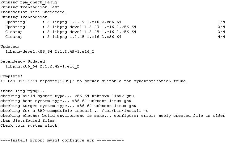

ϴ(wn)ʲôϵy(tng)͛]˸ԵÑҕQˡ
ҵCentOS 6.0ǏFW(wng)վµisoļ wdlinux_base_64_6.iso
Ո(qng)ϴ(li)Q(wn)}ѽx
؈D
ba

DƬ: 1.jpg (2012-4-26 19:49, 86.28 KB) / dΔ(sh) 9615

DƬ: 2.jpg (2012-4-26 19:50, 233.35 KB) / dΔ(sh) 9728
